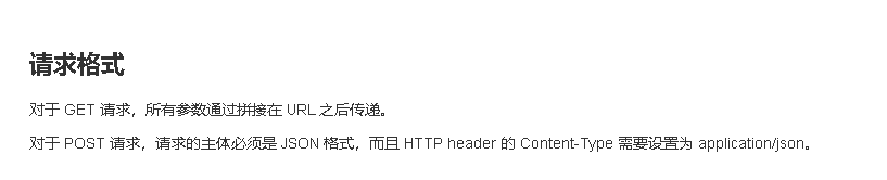

var url='http://【ip】/api/v2/open/worksheet/getFilterRows';
var result={};
var data={
"appKey": input.appKey,
"sign": input.sign,
"worksheetId": input.worksheetId,
"viewId": input.viewId,
"pageSize": 1000,
"pageIndex": 2,
"notGetTotal":true,
"useControlId":false,
"getSystemControl":false
process.env.NODE_TLS_REJECT_UNAUTHORIZED = '0';
const res = await   fetch(url,{
method:"post",
headers:{
'Content-Type':'application/json; charset=UTF-8'
body:JSON.stringify(data)
}).then(function(response){
if(response.ok){
return  response.json();
}else{
return   {"error":"无数据"};
}).catch(function(err){
return   {"error":"Fetch错误:"+err};
result = await   res;
