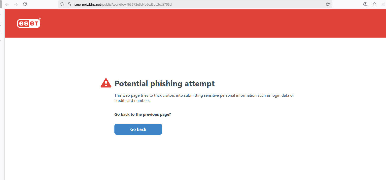

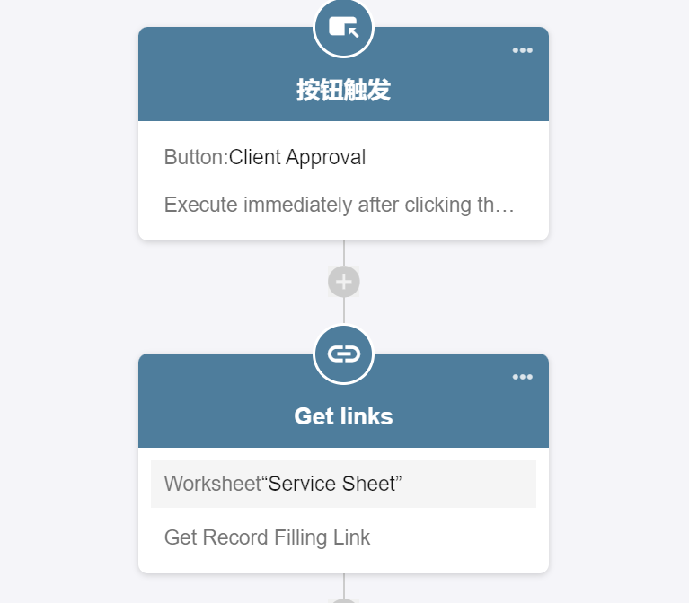

Hi, in our application we usually generate a fill-in link through the workflow to provide our customer a link to fill in the worksheet.
In some cases, this links can trigger the antivirus on the customer side and the customer is unable to access the HAP system.
Is there any way to prevent this from happening?

I just want to update I have managed to find the cause of the antivirus trigger.
The domain we used is a no-ip.com dynamic DNS domain. This type of domain is sometimes associated with phishing and scam websites.
We have since moved to a .com domain and the antivirus have cleared the website and no longer flagged it as dangerous.

But most of the link I sent out is using the "Get Link" function from workflow
I usually get a link and then send it to the customer to fill. But most of the time, customers with antivirus installed will have some issue to access.

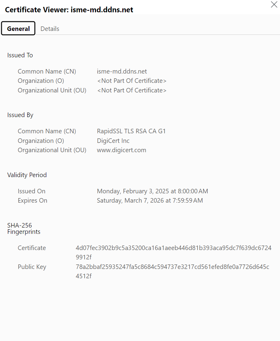

不用,我刚才访问你这个链接看了一下,ssl 没问题,你试下进入公开表单设置,关掉部分的,来源参数 → 设备信息,试下?我用了谷歌、Firefox、360 浏览器访问你的 url 都没出现这个问题。
I have a valid SSL certificate. Is there a possibility I need to change my SSL provider?
