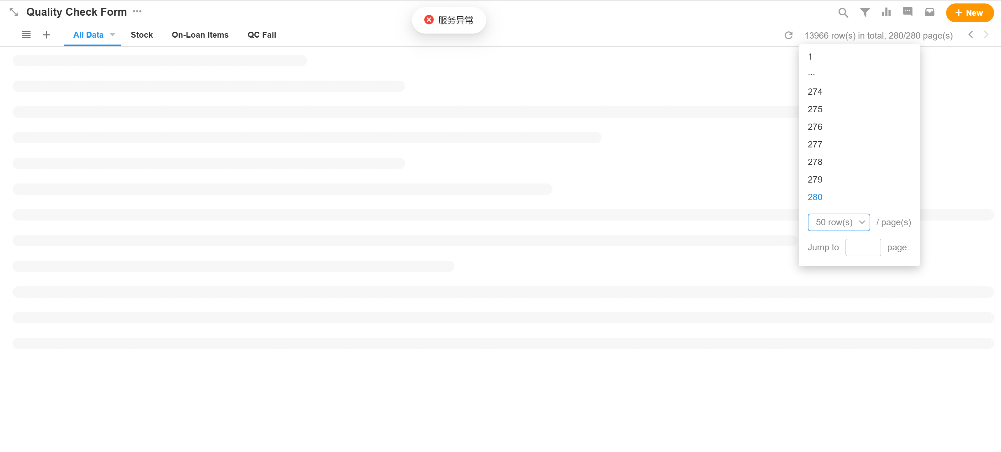

I have a table with about 14000 records as below. The latest 8200 records can be viewed without any problems in table view. However when I tried to browse beyond the latest 8200 records, this error message as below is shown. If I search and filter to retrieve the earlier records, it can still be accessed. It is just that I can't view it in table view.
For information, I do have larger tables with about 30000 records that I'm able to view without any problems. I have also noticed that if I try to create a search acceleration index for this table, it will also give a backend error without completing the task. What could be the issue that this error is displayed?

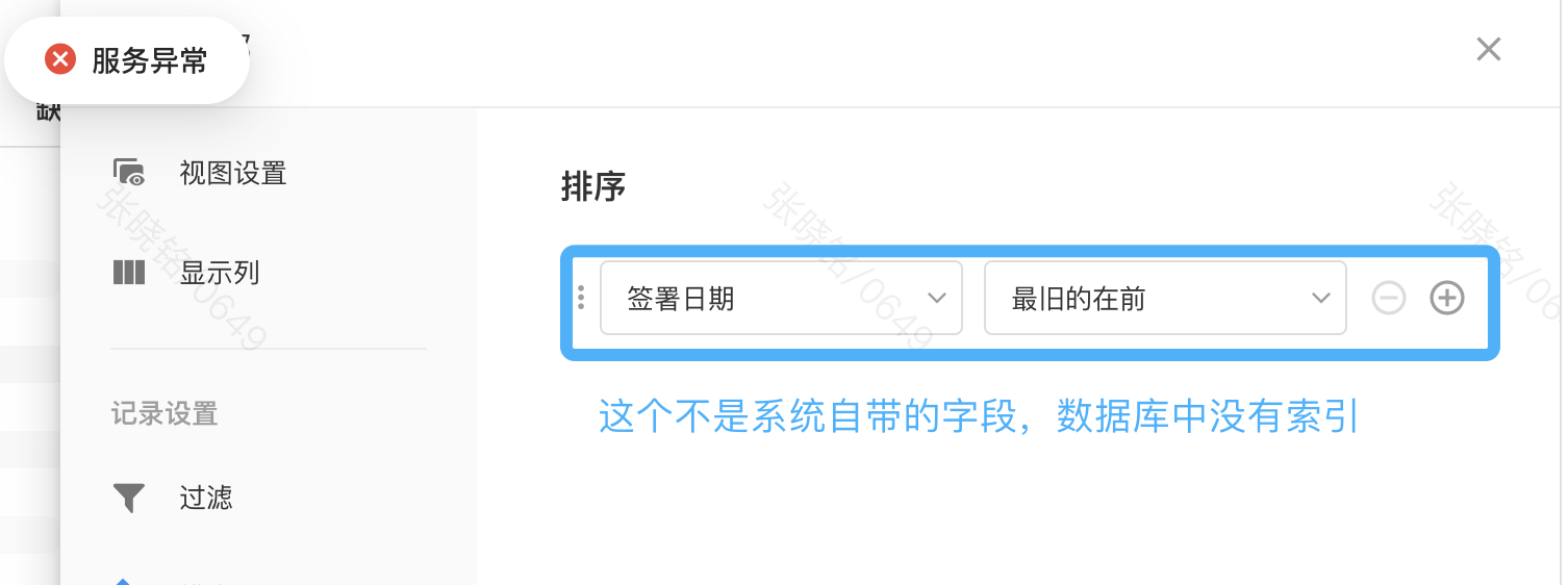

我在 SaaS 官网复现了你的现象,我这边有个表是 60+ 字段,如果我按照自己定义的字段做为排序,那么就出现了如下的错误

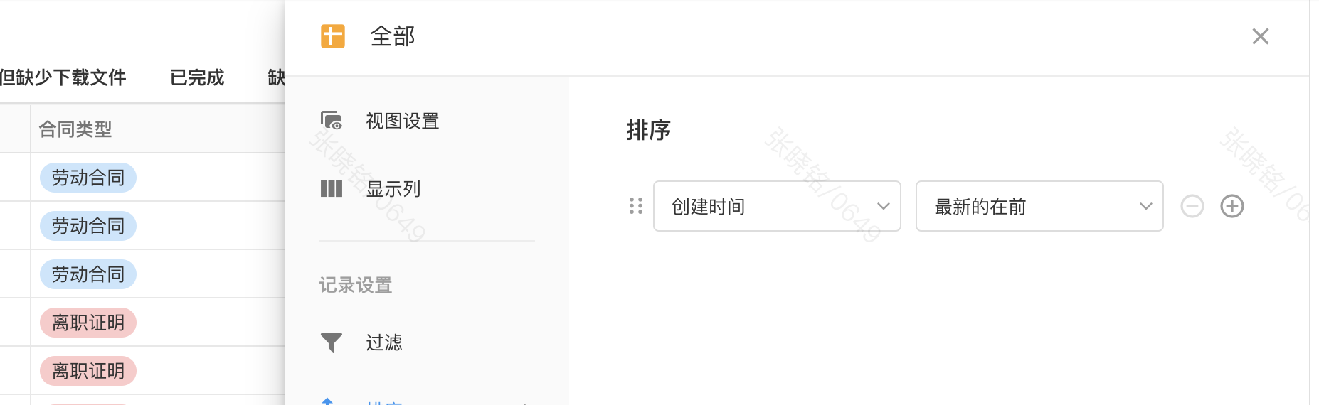

调整下排序字段,改为系统自带的时间字段,推测是 mingdao 默认会增加这些字段的索引,是不会报错

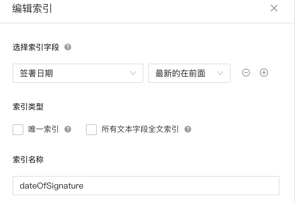

尝试对【签署日期】字段设置了降序索引,设置成功后,就不会再出现报错了。

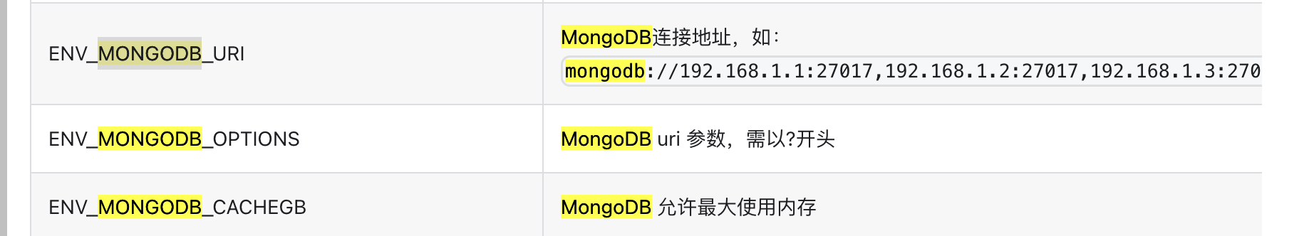

服务异常的报错,通过设置排序索引,可以解决internalQueryExecMaxBlockingSortBytes参数,查看了下官方文档,暂时没有看到这个参数可以由配置文件去定义mongod --setParameter internalQueryExecMaxBlockingSortBytes=63554432。不是非常推荐这么做,不好维护To recap the solution below, apparently the setting is reverted back to original once the server is restarted. Is there any way to make the RAM size increase permament?

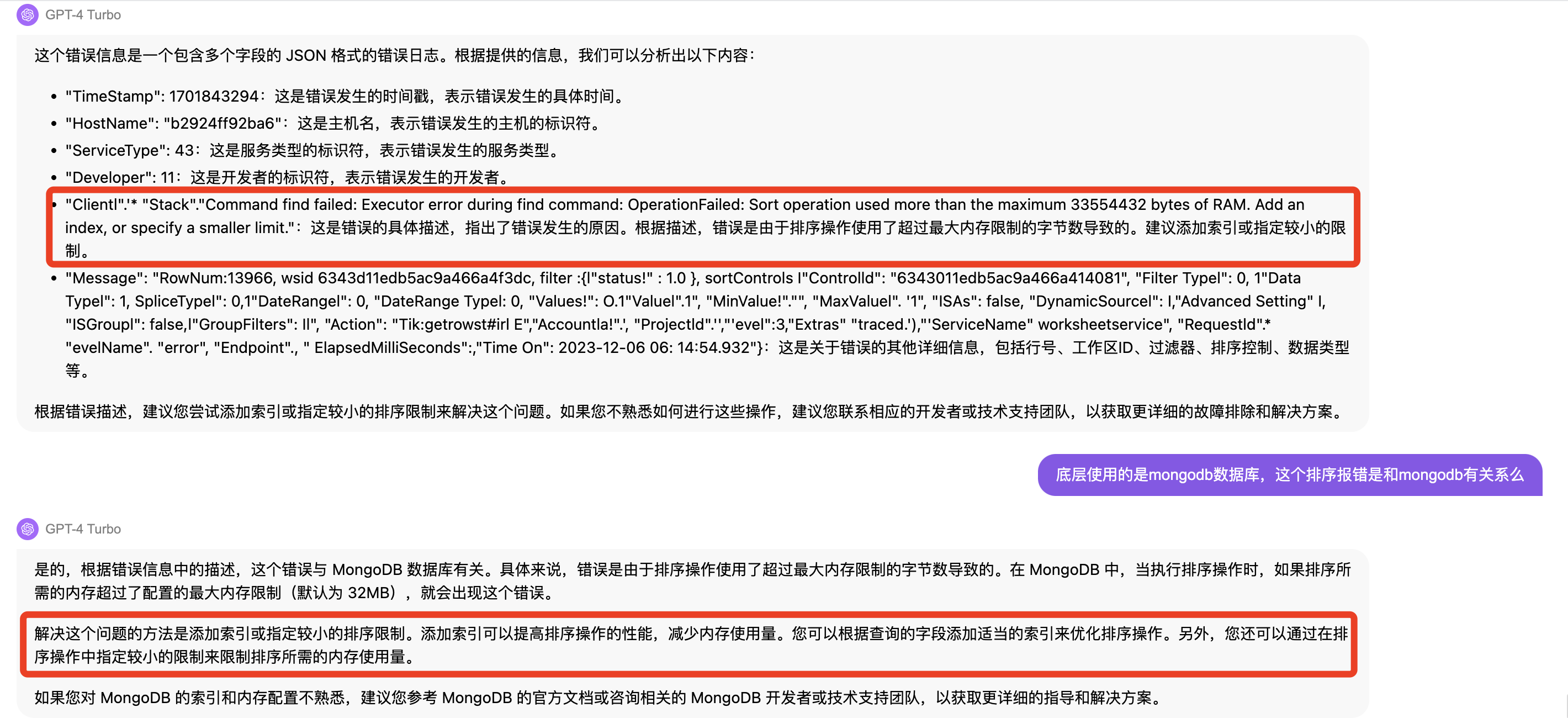

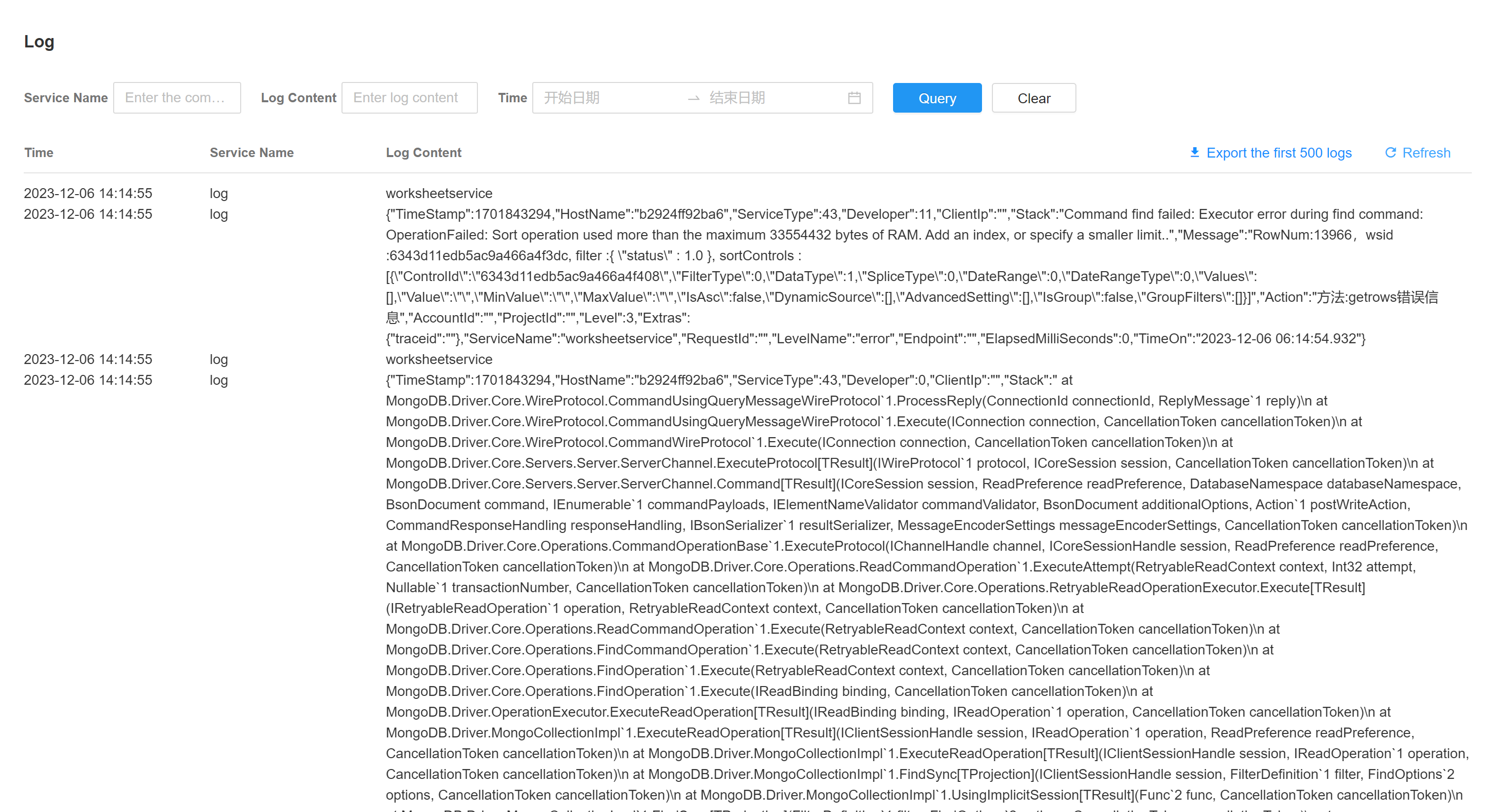

根据你的错误日志,问了下 GPT,看样子就是 MongoDB 的内存不够了导致的,如下图所示:
另外,你这个部署环境,数据量是不是比较大,几万数据,对于 32G 内存部署问题应该不大,如果方便,你可以查看下 MongoDB 的情况

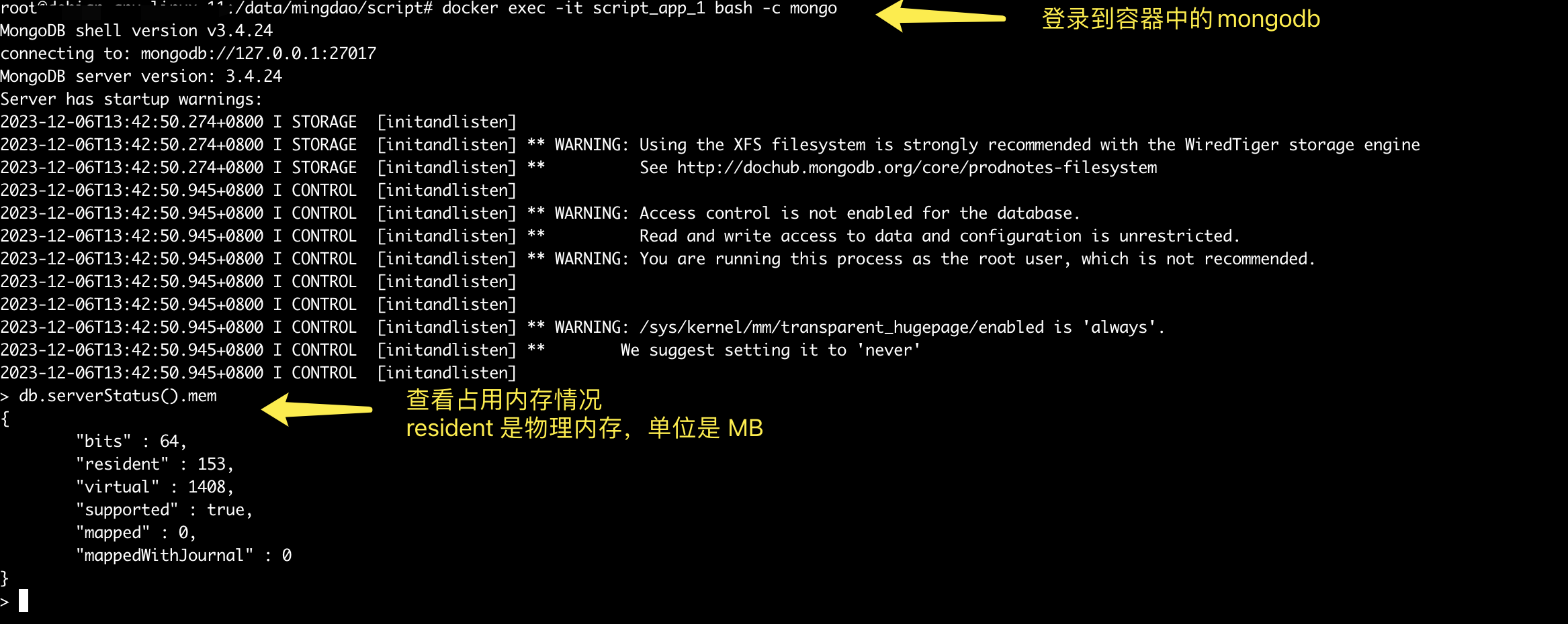

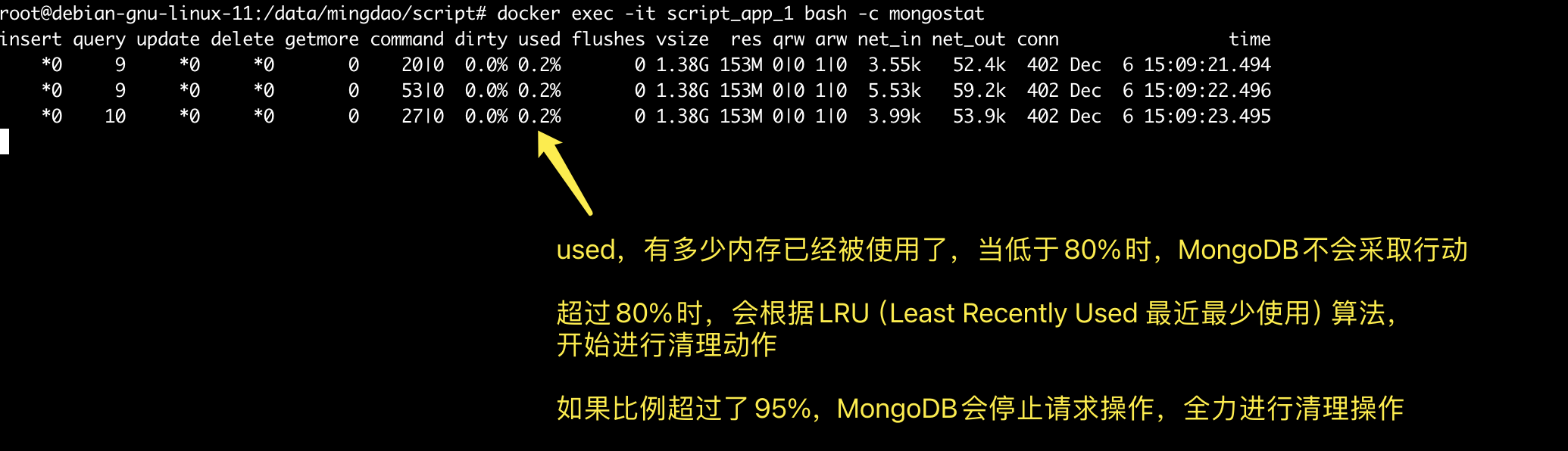

(1)
docker exec -it script_app_1 bash -c mongostat(2)
docker exec -it script_app_1 bash -c mongo然后输入db.serverStatus().memThank you for your advice. After checking the system log, it seems that the operation required more RAM than available. How do we allocate more than the needed RAM?

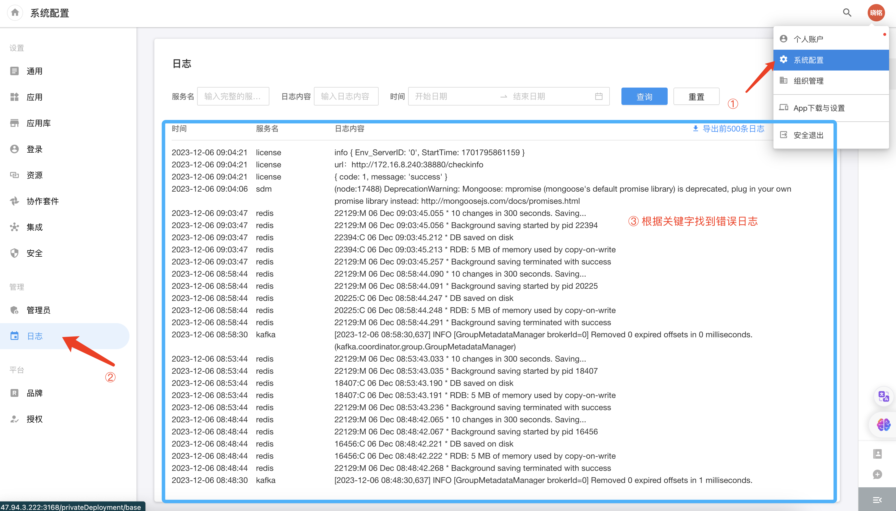

可以先打开【系统配置-日志】页面,然后复现上面的错误,同时观察下日志中的变化,定位到错误信息
另外,创建索引的时候,如果出现错误,也可以用上面的方法
总之,先观察下日志的,从日志进一步的定位
